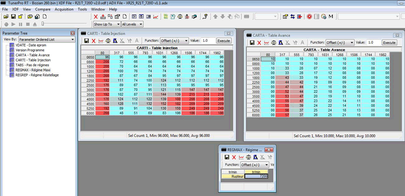

I already have a Bozian bin but it only displays up to 1982mb & 6000rpm?

The pressure steps are "numerics" in the definition file and don't match the 3b map sensor specification, only the original 2b map sensor.
If you want to display the real 3b map sensor pressure step, you have to modify the xdf file.
About rpm : rpm are calculated by the xdf using the .bin informations. Bozian use the rpm step as they are displayed.
